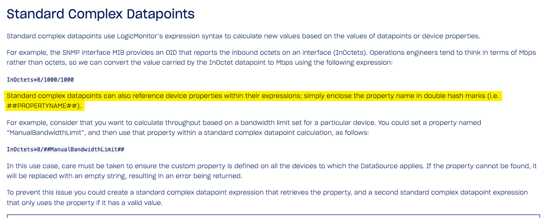

·3 years ago@David Bond Well sort of. You certainly can access custom props and ILPs within Complex Datapoints, but only if they are integer values.
So you can’t do this:
But you can pull number values and use those just fine.
https://www.logicmonitor.com/support/logicmodules/datasources/datapoints/complex-datapoints#standard
