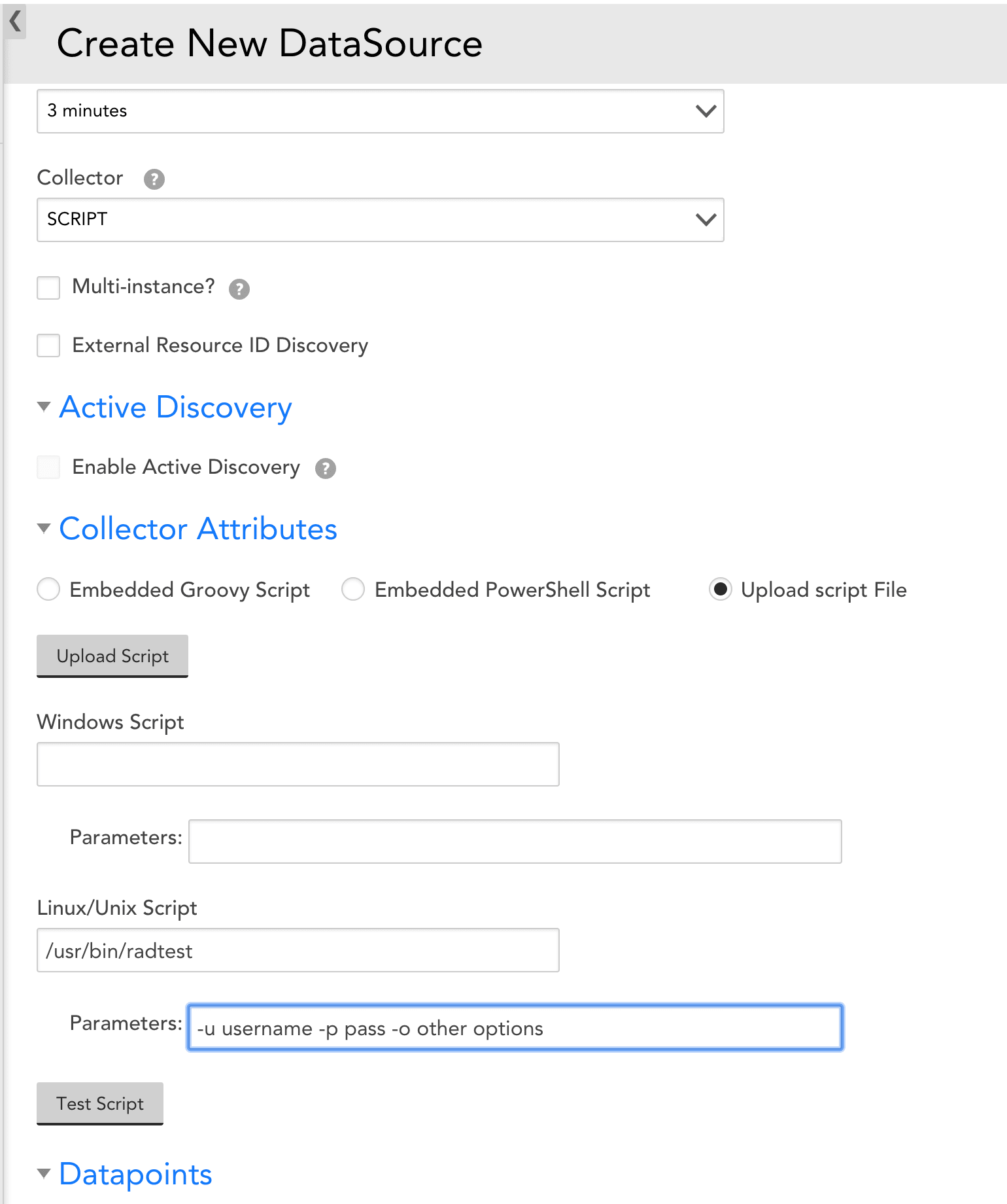

·7 years ago@Dennis Walcott thought of a codeless way to do it.
If you have a command line utility that allows you to test RADIUS (I used radtest from freeradius) you can just install it on your collector and call it with the "upload script" type Datasource.
Presumably the cli utility will give you back something you can easily regex for in a datapoint, "SUCCESS" or "FAILURE" gets printed out if I remember correctly.

·7 years ago@Dennis Walcott I've done something similar in another monitoring tool in a past life. I used a script that called a radius test client and made a request directly to the RADIUS server. Parse the results and return a simple 1 or 0 for failure or success.
I would probably go with a DataSource over a webcheck in this case.
You can use Expect to run the radius test client if it's installed on your collector.
