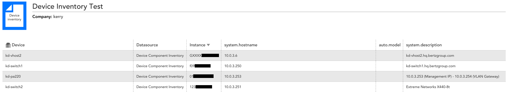

·8 years ago@Joe Tran - that might be for the inclusion of instances that contain device information - which I believe comes from the time before PropertySources existed. For example, the Device Component Inventory DataSource often returns the serial number of a device as the name of an Instance:
That is a best guess - that DataSource also populates with installed hardware, depending on the device.
