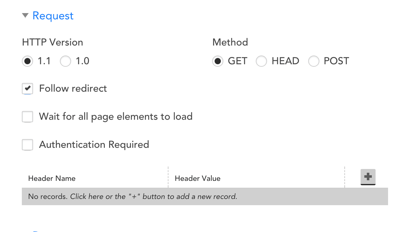

·8 years agoWhen you add a web service check you have the option of adding arbitrary headers. You could create 6 checks, 1 for each app on each web server. Use the IP address of the webserver, then just add the relevant host header. If the webservers aren't reachable by our site monitors you'll have to use Internal Service checks, but the UI is the same:
